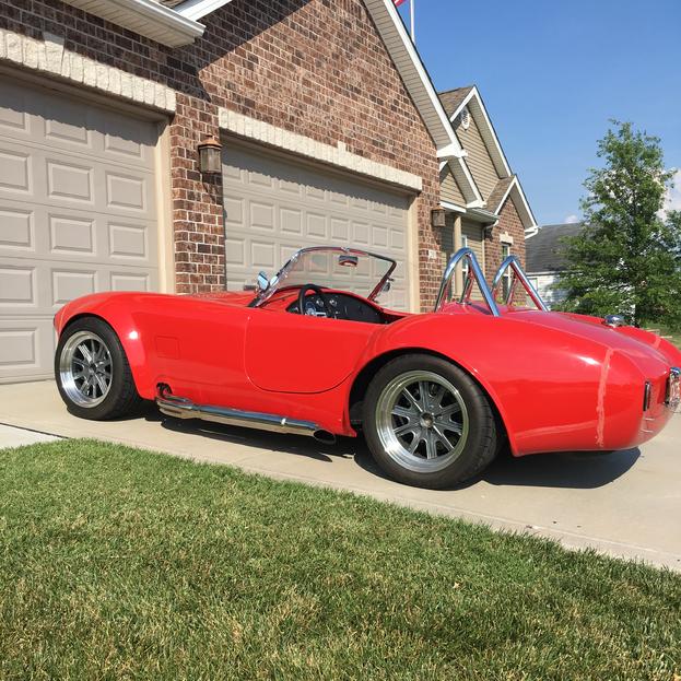

Factory Five wheels are 9" front and 10.5" rear. With recommended tire size of 245/45/17 front and 315/35/17 rear. Some people up the front to 255 because the 245 looks a little stretched. You have the correct wheels just too big of tire on the front. Here is the link to Factory Five it has all the information on it. http://www.factoryfiveparts.com/14865-17-x-9-and-17-x-10-5-vintage-halibrand-replica-wheels/ Why would you not just get smaller tires?? The specs for a 245/45/17 tire is a 7.5" - 9" wheel. Your 9" wheel will work. It's what everyone who has Factory Five wheels are using.
This is a 245/45/17 tire on a 9" Factory Five Wheel.
