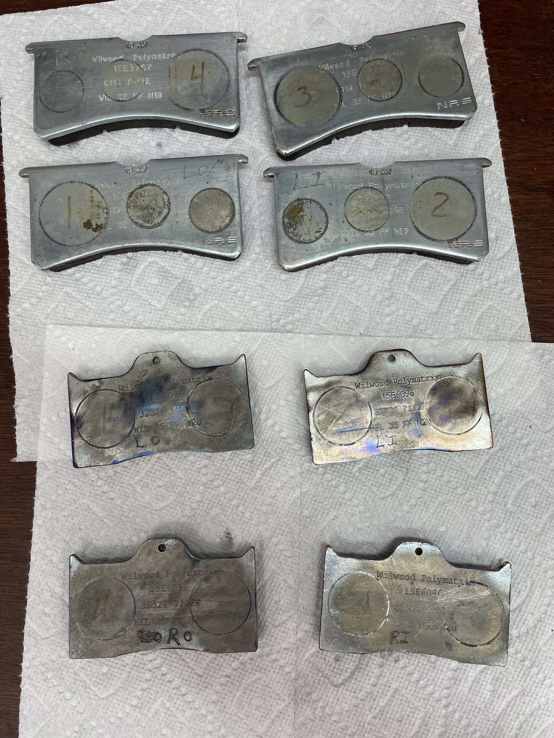

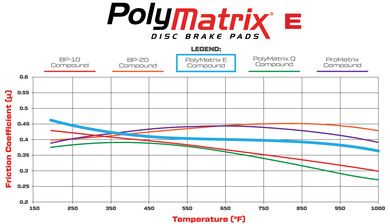

I do have race/ish pads. Wilwood Polymatrix E. The rears are getting pretty hot compared to the fronts. The backing plate steel shows signs. Blueing etc.. Not sure if it’s steel or stainless. So anywhere between 500-800 deg I’m guessing. I think I noticed where the rear pads lost some friction. I started having a little more pedal travel. Never felt I was loosing brakes though. I actually was wondering if I need to adjust to a little more front bias. You can see in the chart how the friction drops off from initial bite but then stays flat.

I don't think having your rears hotter than your fronts is a good thing. Having more front brake bias than the rears during high speed deceleration adds stability. I'm interested on your thoughts on why you went with the PolyMatrix E? Out of the 5 I only ever considered the BP-20 before going with another brand/model. I agree with holding off on the slicks, they tend to hide driver input errors. Not a bad idea to improve while on 200s. Great to see you getting it Tony! Wish I could be out there with you guys 👍

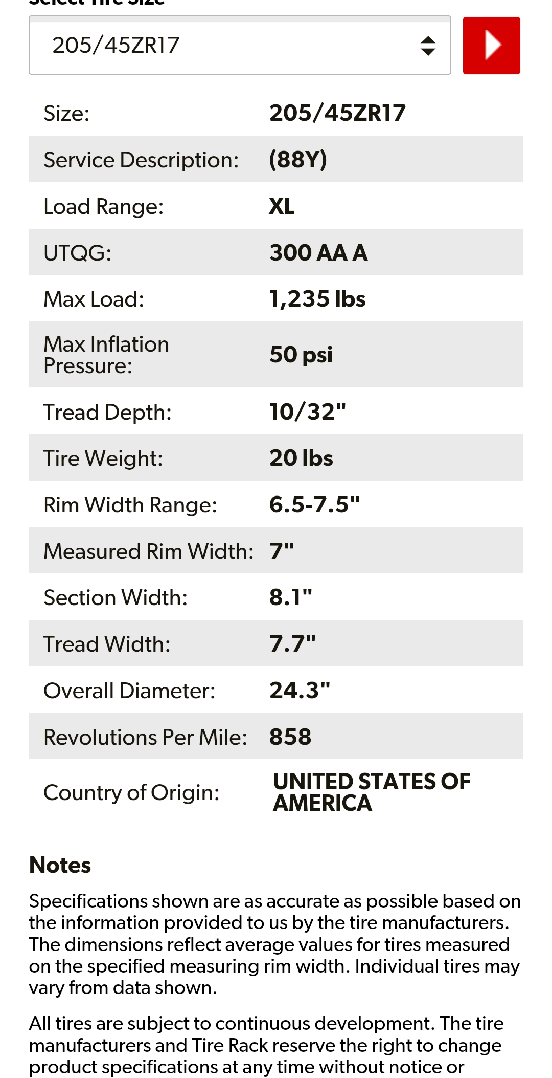

I've learned, 200 vs 320 vs 540 is just a tread wear rating.... Not a grip rating. The traction rating AA is what you're looking for. See my tire specs in the pic. But yes, generally speaking, the smaller the TW rating, the softer the tire... Not necessarily better grip. So, don't judge your times between you and Rick on tires. Two different cars. Keep making smooth laps, you will see improvement. Work on consistency. Don't just run one, two or three 1:18's, make that your normal lap.

Steven, when I set the brake balance I initially had the rears locking up first. I adjusted the balance bar slowly towards the front till I got the fronts to lock up first. I tested it a few weeks ago and still had the fronts lock first. So it’s most likely set at just slightly front balanced. As the rears heat up with these pads the car becomes more front balanced. (If all equal and I used the BP20 as the rears got hotter than the fronts I would possibly end up rear biased. Due to more friction with heat.) I don’t know how much front balance would be too much. Can I cause too much weight transfer that the rear becomes light? I think I’m going to buy the remote adjuster to make it easier to play with.
I didn’t choose the Poly E pads. I upgrade my Factory Five Wilwood brakes with Gordon Levy’s bigger Wilwood brakes. (Gordon is a Professional builder and parts supplier of Factory Five cars. And racer himself.) The Poly E is what he includes with his kits. His brakes are definitely an improvement over the Factory Five. I use the BP10 on the street.
My thinking is the rears are smaller with less pad volume causing them to not dissipate the heat as well or heat up easier than the fronts. The fronts are doing more work but capable to handle the heat better. Makes me wonder if Gordon use’s the PolyE pads for that reason. Rears get hotter than the fronts causing more front bias instead of possibly ending up with rear bias as they get hot. Might be worth giving him a call.

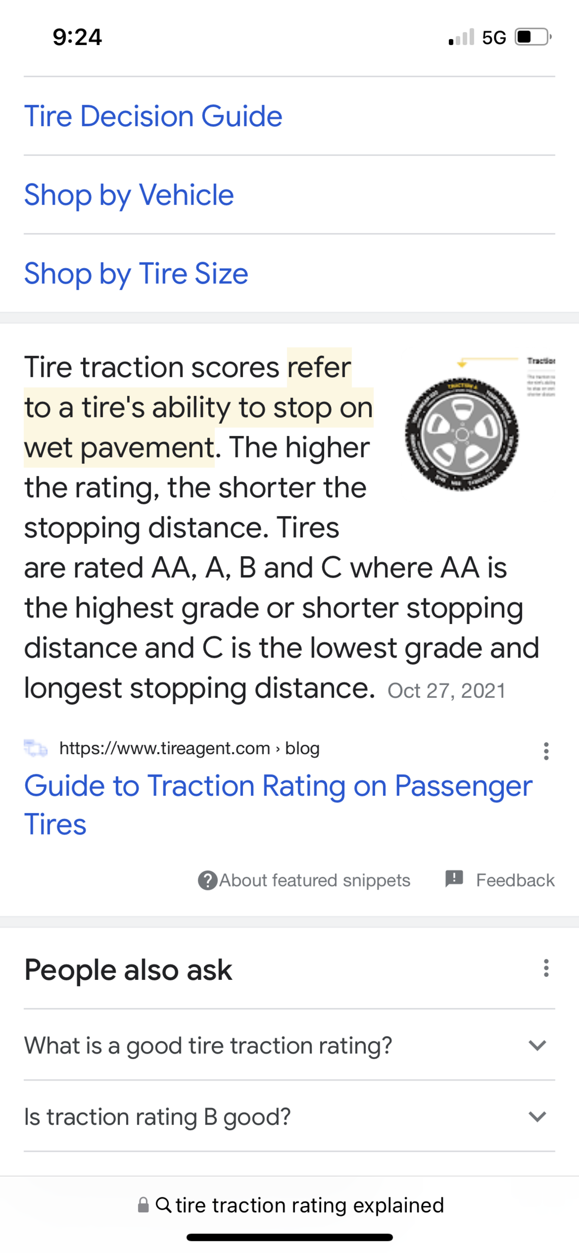

Tim is that true? Why are the Hoosier slicks rated as C. (Refer to my tire size thread. ).
Notice they are taking wet stopping distances. So, an AA would stop better on the wet than a slick obviously

Ok, I talked to Gordon. He said I do need more front balance. The rears are working too hard. Said it should help oversteer when trail braking in corner entry also. But did say these cars don’t like trail braking much. Also said I could step up to a BP 30 if I wanted. If I still needed more front balance and run out of balance bar I could use a BP10 on the rears. Also said I would use 2-3 sets of rear pads to front. Just because they are so much smaller. I’m going to order the remote balance adjuster.
