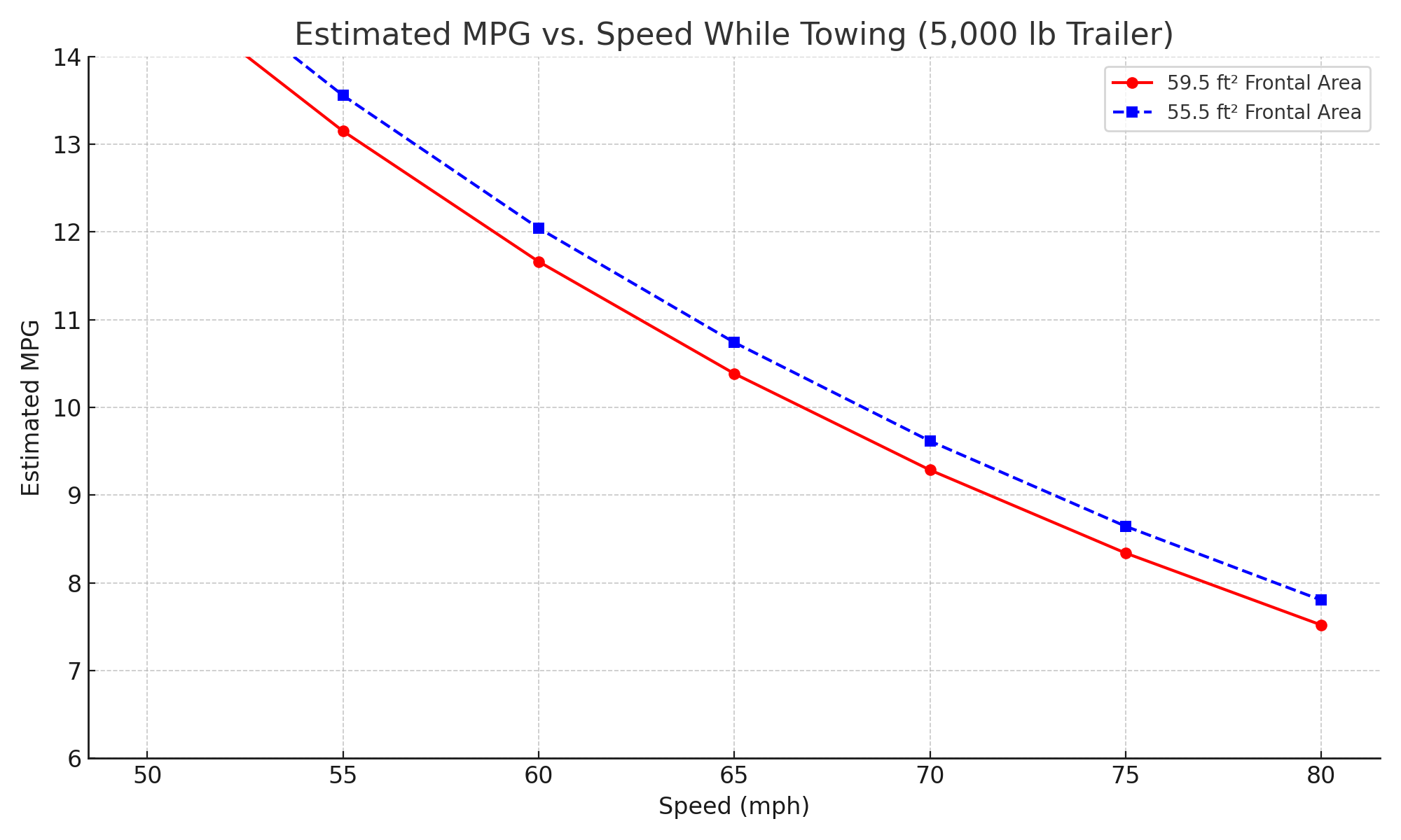

As some of you are aware, I'm trailer shopping. Been looking at 8.5' x 16' trailers with both 7' and 6' 6" height with 3,500 lb axles. Have looked at a few and found several. And before anyone suggests Viper Trailers, I've found them to be unresponsive. I've called, sent emails and visited the store to request a quote with zero response from them. So, not considering them.
I played with AI this morning and learned the following
  • A 7' tall tailer has a front surface area of 59.5 feet squared while a 6'6" trailer has a front surface area of 55.5 feet squared. The difference in wind resistance is 7.2% higher on the 7' trailer
  • Most all of the trailers I've looked at weigh 3,000lbs empty
  • I asked AI to calculate MPG on my truck considering it get's 22mpg at 75mph without towing a trailer.
  • I asked AI to provide a MPG / Speed chart using the surface area, and a 5,000 lb trailer (trailer + car). This didn't need to be exact, and, I know my car weighs more, but, AI determined that the rolling resistance doesn't affect MPG as much as wind resistance. It does, just not as drastic.
  • Obviously, the slower you go, the better the MPG.
  • I've determined that for as often as I tow the trailer (2 - 5 times per year) that, I'm not THAT concerned with MPG as much as I am with ending up with a good trailer that will last as this is the last one I'm buying
  • Below is the charts comparing the 7' to the 6' 6" trailer. You may find other variables to add, but, I reached my data analysis limit on ChatGPT today :oops: Maybe this info will help others looking at buying a trailer.

Interesting, it is almost linear: 5mph costs 1mpg.
I see the different approaches to aerodynamics, but I think their benefits are incremental. The big factor is still the drag of the frontal area.
You can streamline a brick but you're still pulling a brick.
I agree with Paul's comments and Tim's thoughts on just getting a quality built trailer!
Even the slanted front of my 7x16 hardtop Serpent Express only helps mpg marginally. And it only weights 1650 lbs empty! There's still a lot of surface area drag. I only lose about 1 mpg towing with my cobra inside vs empty. I find that my mpg is affected more by head/tail wind, drafting, speed and hills.
Never checked it… course a pull with a powerful SUV… to me feels effortless… got to watch speed ..: can creep up on you all sudden you’re doing 80+ without trying… no issues with my 8.5x16 w/side door… pulls perfectly…

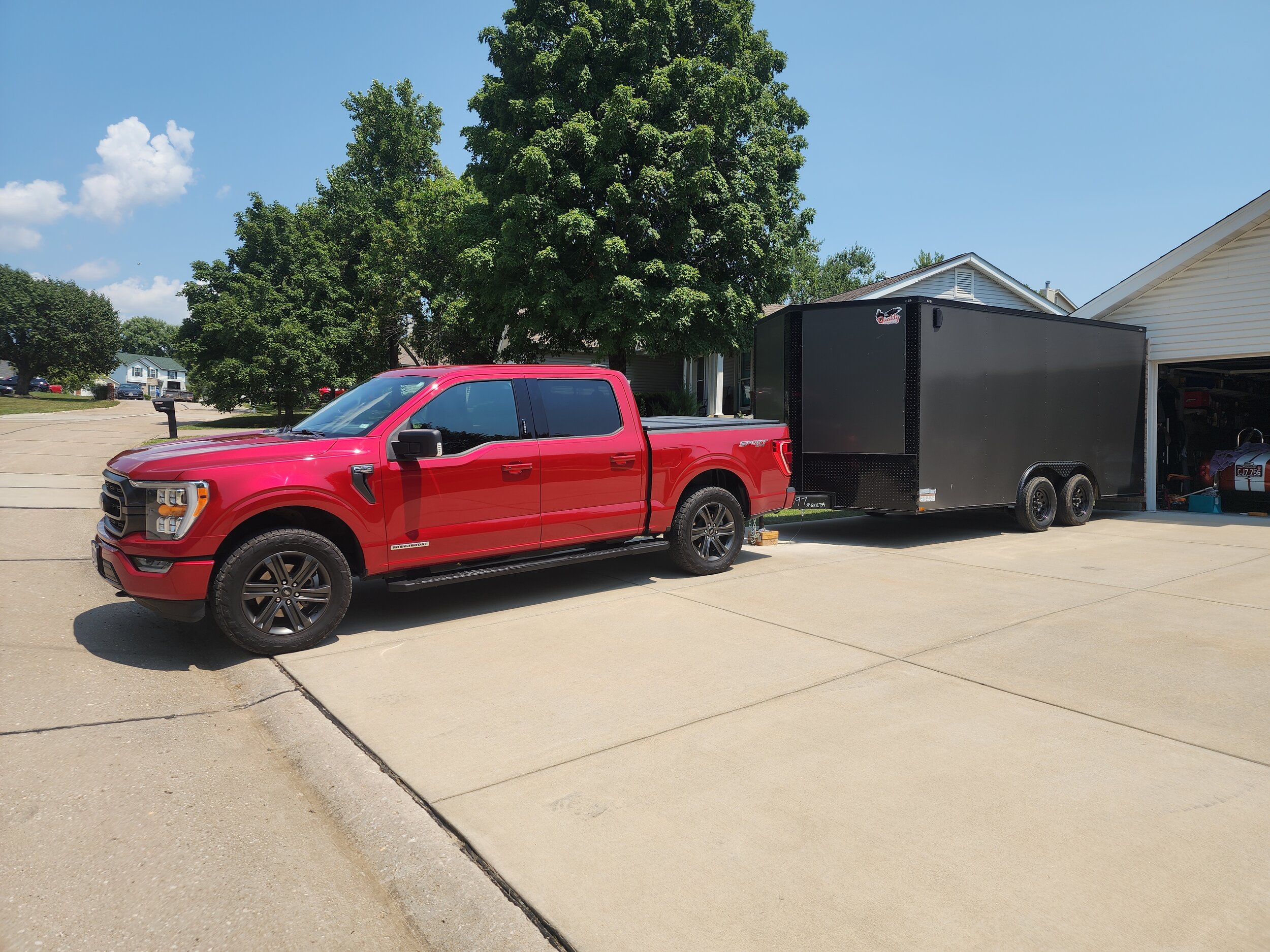

Trailer purchased and Colorado will be it's maiden voyage :D
8.5 x 16
3500lb torsion axles
7' interior height
Polycore exterior walls
3/8" interior walls
3/4" Plywood floor
Steel frame
Viper never got back to me, so, moved on.
