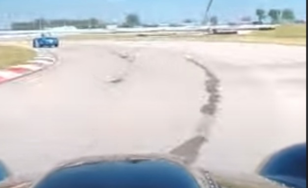

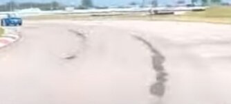

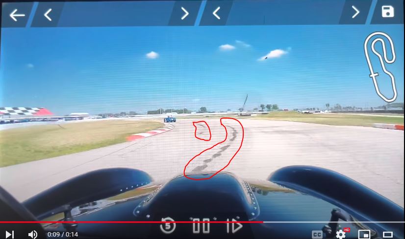

Posting my spin, maybe club could learn from my misfortune. I misspoke, based on the video I had completed my braking (straight line) prior to turn-in and was on throttle thru the turn. This morning I was thinking maybe (front or rear) bump steer played a factor 🤔 (couldn’t download from Garmin, only way was to record using phone)

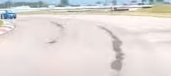

just noticed these possible "damp" trails from the video :unsure: From the video, I'm on throttle, the rear is loaded, and spins (loses traction) when I hit the trails.
Well, we know it wasn't from rain. This is yet another issue with running with a group that has untrained corner workers. I'll almost guarantee you the SCCA guys would have seen that and gotten it cleaned up. I suspect the blue Audi that was towed back to the garage area or one of the many new drivers that didn't think their leak was any big deal. This sux
It looks like 2 distinct trails. I remember the the Subaru that came in and parks behind us said they lost their brakes on the course and the had to refill and re-bleed them in the covered area. Just another possibility.
Upon closer inspection, those are pavement patches. Darker asphalt it appears

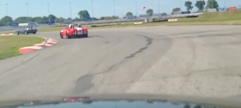

Can also see in my video of Rich's spin
I think you're right, does look like a patch, and thats not really where the spin was
True, but wouldn't it be right after? Looking at just the picture, it seems the spin was quite a bit after?
I just know in my case that wasn't part of the reason. My spin was much later in the day, so if that had been liquid, I think it would have been gone by then.

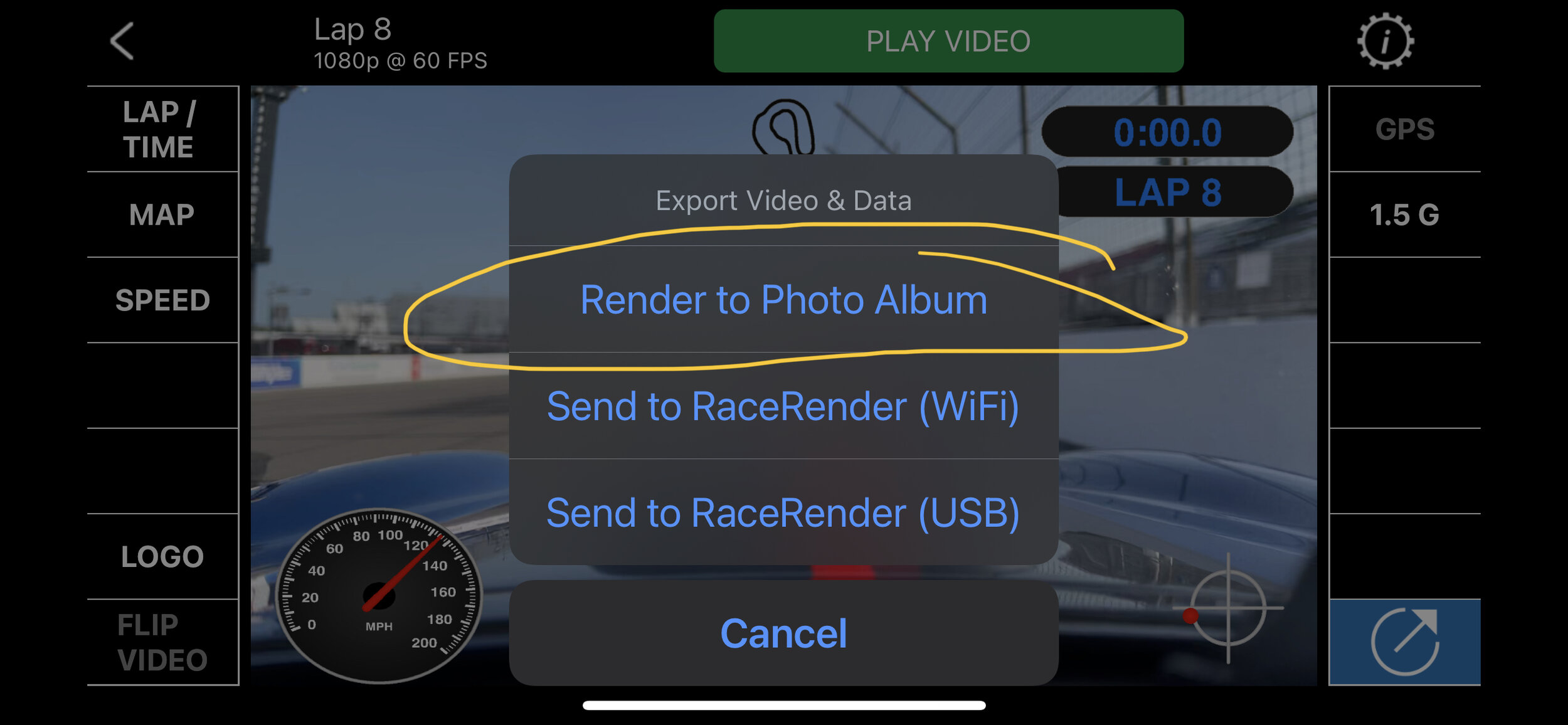

Tim the IPhone let’s me save the video directly to my phone really easy. Do you not have that option?
Yes, but, I'm not Rick 😁. He transferred the data to a thumb drive because he has an old computer that wouldn't run Race Render. He has another video that is vertical that I can't rotate unless I purchase the program.
