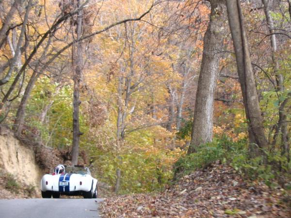

Paul Proefrock's car is the car of the month on the calendar. If you don't have a calendar, it's a great picture of Paul's Hurricane. Take the story away Paul and fill us in on the details.

I did the rough body work and sent her to Murrill for the final paint. Struggled for two years over paint choices. I thought I wanted white with one blue one red stripe like the Racing Beat Miata but that scheme just didn't look right on the Cobra body. I saw the 350GT photo below in an O'Reilly calendar and that clinched the color scheme. Ford Performance white with Blue stripe and Red pit stripe.

A special thanks to Mark Earls for the calendar. I took the photo but he touched up the image to really turn it into a great shot.
