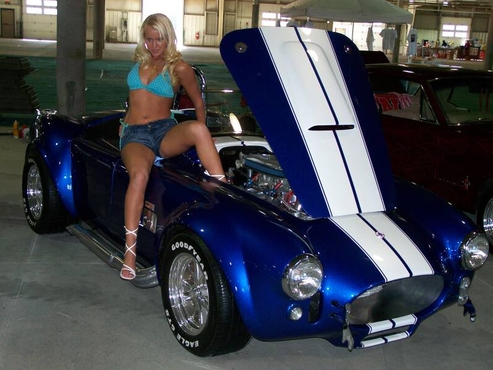

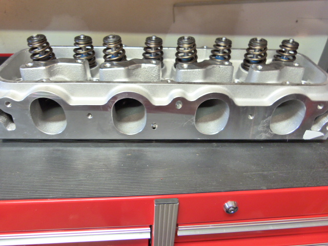

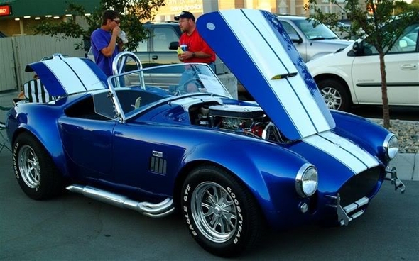

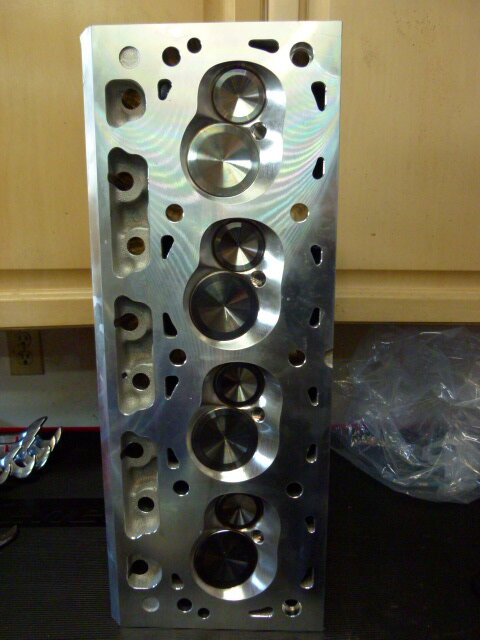

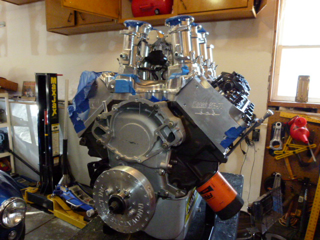

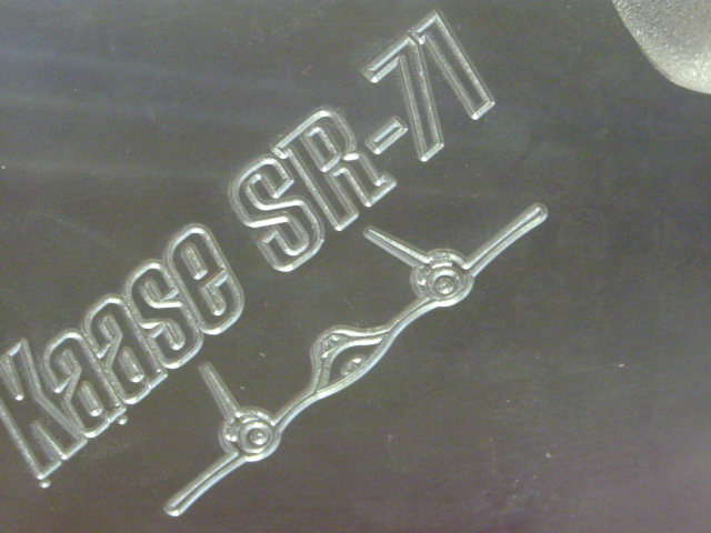

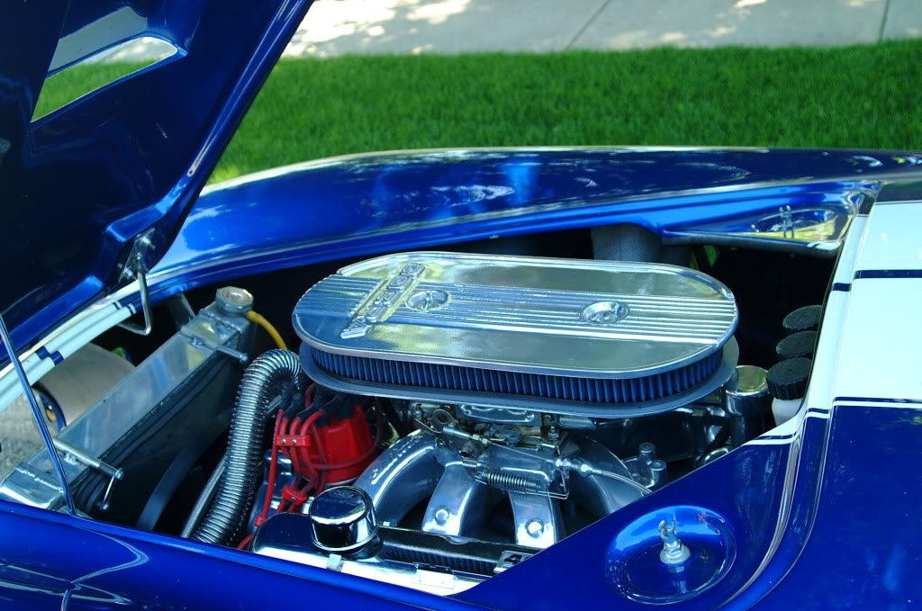

We don't have much for Cobra forums here, even though Shell Valley and what used to be,..Midstate Cobras. are local, they don't really have much for forums or for my Cobra. I built a 2000 Lone Star Classic Cobra way back in 2001 with a 428 FE, then rebuilt it in 2004 for more power. I wanted 600 HP, but when I spoke with one of the best FE engine builders Barry Robotnick and he said getting that HP with the 428 is asking for trouble, so he said build a Ford 460, and that's what I've done. I'm giving my Cobra a rebirth in the drivetrain so the is a Ford Motorsports 460 which is a lot stronger than a truck block, stroked to 527cu. all the good racing parts. Kaase SR-71 loaded heads, his roller cam & valvetrain, a cool stacked,...EFI with Holley's Terminator brain. New Tremec TKO 600, McLeod billet aluminum fly, their dual disk clutch and it's all balanced. It should be around 750 Hp/TQ.
I raced go-karts at age 7, mini sprints for years, then to the 360 & 410 dirt wing sprint cars for 21 years, so I yearn for light weight overpowered HP cars. :cool:
I know that a lot of the Superformance Cobras have the 460 and several people said that engine would fit fine in my LSC, but man,....it's tight !
The engine is in the car, but the stainless steel headers are going to be a bitch to make.....at least on the drivers side. The steering column, the rag joint and rack are in the way. But I'll figure it out.
I look forward to meeting you guys and chatting everything about our toys. (y)
Kevin
(the engine pics in the car is my last FE)
