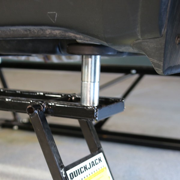

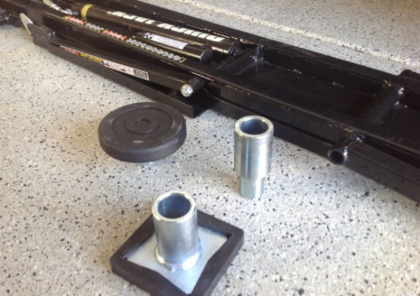

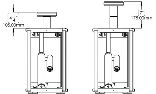

However, the frame height is tall enough that even with the SUV adapters it will need to rise 5" from the zero position before it makes contact with the frame.
One option I do have is that the SUV adapters have multiple parts which can be stacked for a lower height. This would allow for a greater rise before contacting the frame rails.
That would offer some added mechanical advantage that should help to reduce the load when lifting.
See the attached images...
