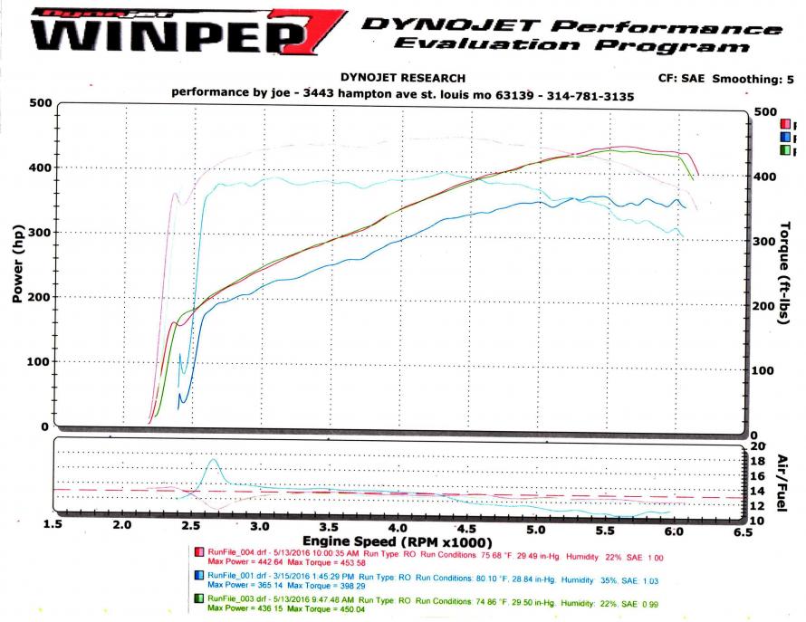

My initial pull showed only 365 hp and 398 ft lbs of torque, at the rear wheels. And it was way too rich up top. I'll try to attach the report. This is obviously very disappointing. At the rear wheels, it should have shown something like 420 to 440 hp. Joe and I talked about it and I decided to change the distributor and rejet it. I made an appointment for six weeks later.

A visit to Joe and the first pull this time resulted in a bunch more hp and torque, but it was now too lean--probably because it was now getting the spark at the right time. He told me to go up three sizes on the primary and two sizes on the secondaries. Next pull, it was perfect. Almost perfectly matching 12.7 to one Air/Fuel ratio all the way up. Horsepower was now up almost 80 hp to 443 at the rear wheels. Torque was up 55 ft lbs to 454 at the rear wheel. Needless to say, I'm thrilled. According to Joe's calculator, for a Tremec, this translates to about 510 hp at the crank.
Yes, I have a single plane manifold, which now makes it a 427R, instead of a 427SR. 427R's are supposed to be 550 hp. While 427SR's are 510 hp. However, Roush tells me that the dual plane engines have a different cam, which makes more low end torque. My engine now makes more than 420 ft lbs of torque (at the wheels), all the way from 2700 RPM to 5500RPM. This is more than 500 ft lbs at the engine. So, I'm guessing that my engine splits the difference between a 427R and 427SR. More low end torque than the 427R and more horsepower than the 427SR. I'm happy with the additional low end torque.
