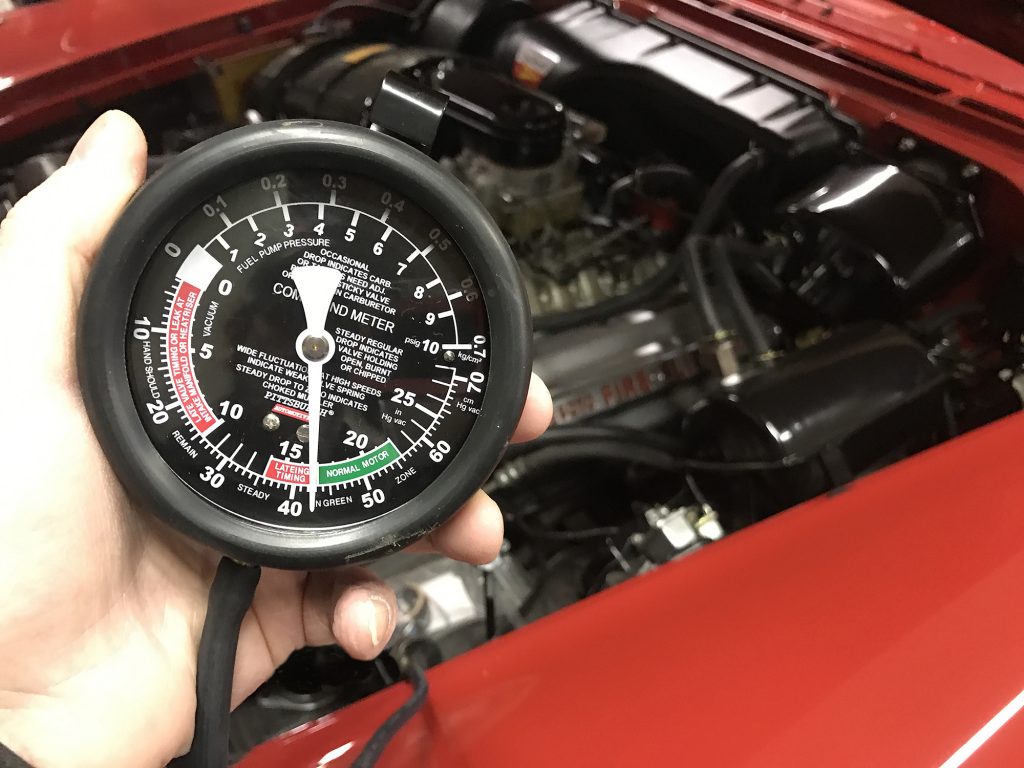

To get started, hook the vacuum gauge to an intake manifold vacuum source. Manufacturers install ports on their manifolds for lots of different reasons: Brake Booster, PCV tube, EGR Switch, A/C vents, etc. You simply need to find one small enough for the vacuum gauge line to slide onto firmly. This is also done with a tee on an existing line or pulling a line and connecting it direct (for example, the vacuum line to the transmission can be used). Start your engine and allow it to come up to operating temperature before testing.

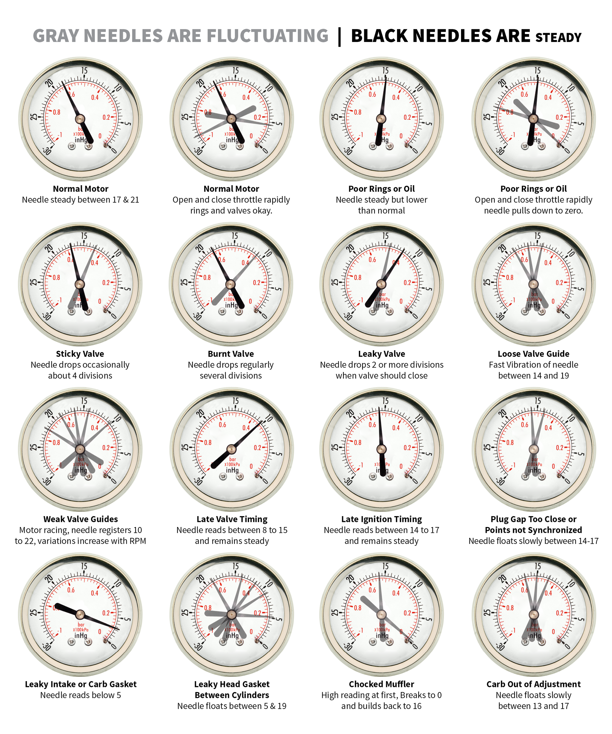

Common Vacuum Test Results:​
Normal Engine: On most engines, accelerate to around 2000 rpm and then quickly release the throttle. The engine should snap right back to a steady 17- 21″hg vacuum.
Steady low between 5-10″hg vacuum: This indicates that the engine has a leak in the intake manifold or the intake gasket.
Steady low between 10-15″hg vacuum: This reading indicates late valve timing. There’s a chance the vehicle has jumped timing. Check the timing belt or chain depending on the application.
Steady low between 15-18″hg vacuum: This low reading indicates retarded ignition timing. Advance the timing on the distributor to correct this problem, and recheck vacuum.
Fluctuating Needle: A fluctuating needle indicates there’s a problem with a valve or a there’s an engine misfire.
Needle drops during acceleration: If the needle drops steady during acceleration there’s a restriction in the exhaust or intake. This is typically due to a clogged muffler or exhaust system.
Also see vacuum gauge chart.
Print it out and hang it on your tool box, and you’ll never second guess what your gauge is telling you!
